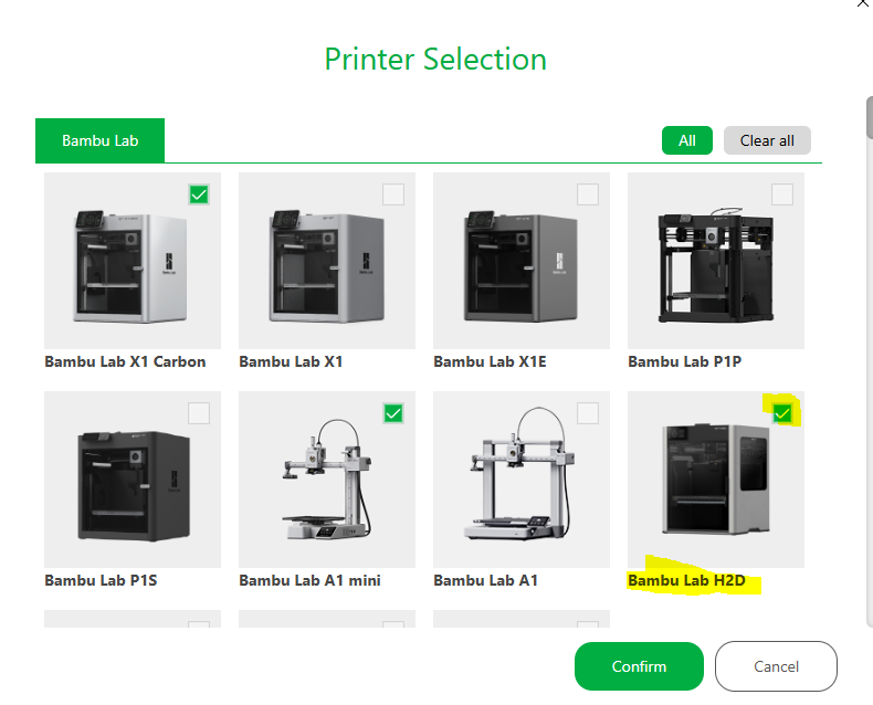

- To ensure you can use the printer in the Bambu studio slicer you will have to add it. Follow screenshots below....
- First click the dropdown next to the printer (Prepare tab) and click select printers...
- After clicking highlighted option above the following screen will appear. Click and put a check-mark next to H2D and click the continue button.
- Do not un-check the X1 or A1 Mini as that will remove the printer from your Bambu Studio profile.
- Once the printer type is added Bambu Studio will now be able to select H2D in printer types for slicing and see it in the devices page.

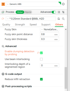

- Recommended: add the clumping detecting when switching from X1 or A1 mini profile to H2D. You could be prompted with a message.
- Here is the Bambu Wiki on Clumping detection.
- To add the detection select click the checkbox under the others tab and scroll down to the Advanced section as shown in the below screenshot.
