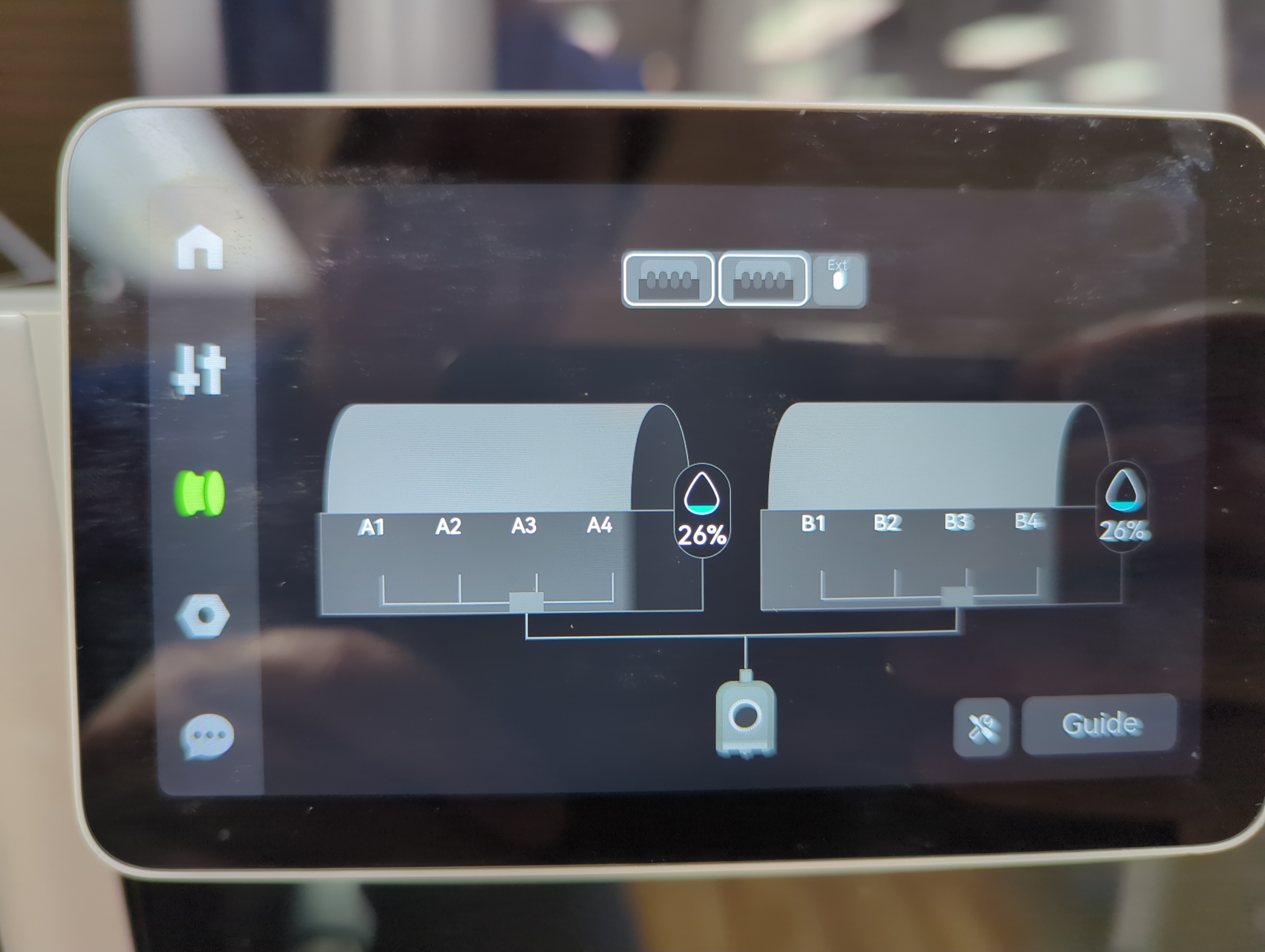

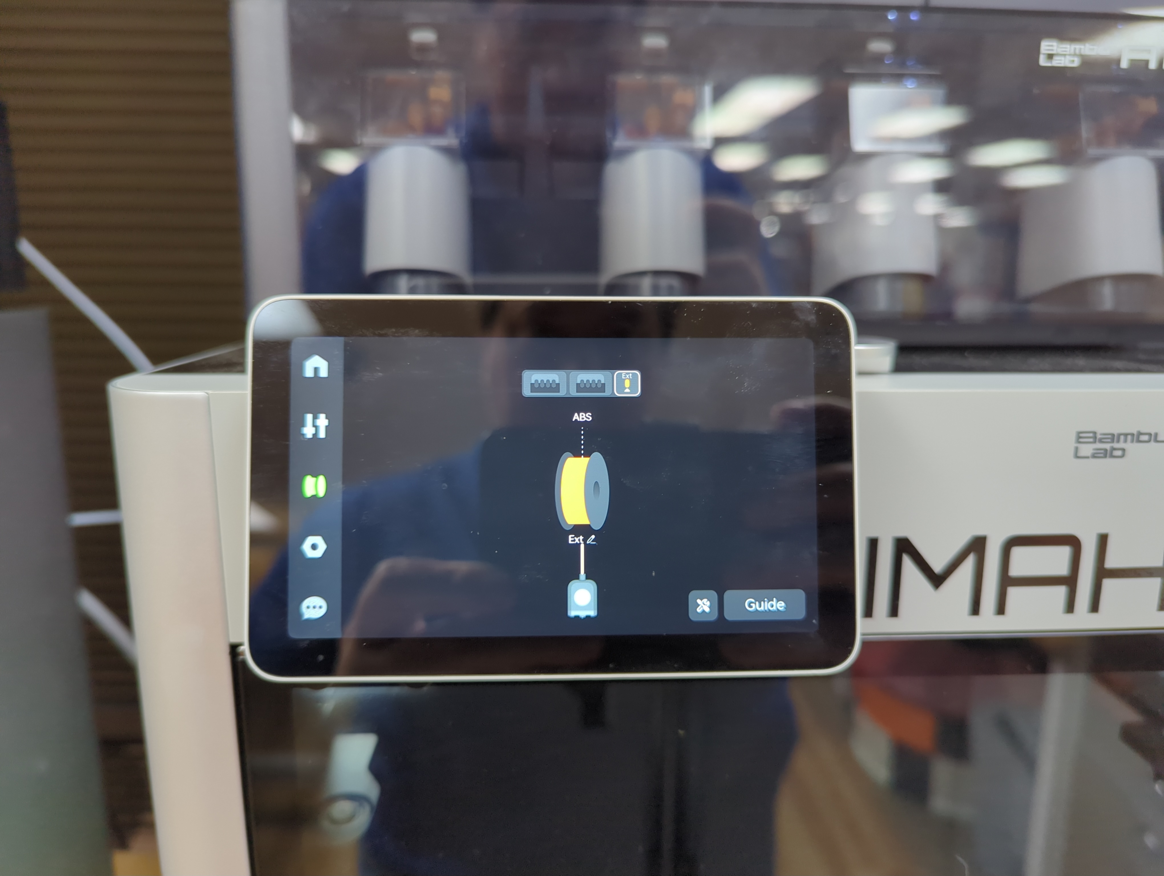

    • The Bambu screen will show a line from the single spool icon to the extruder head when the sensor detects the filament.

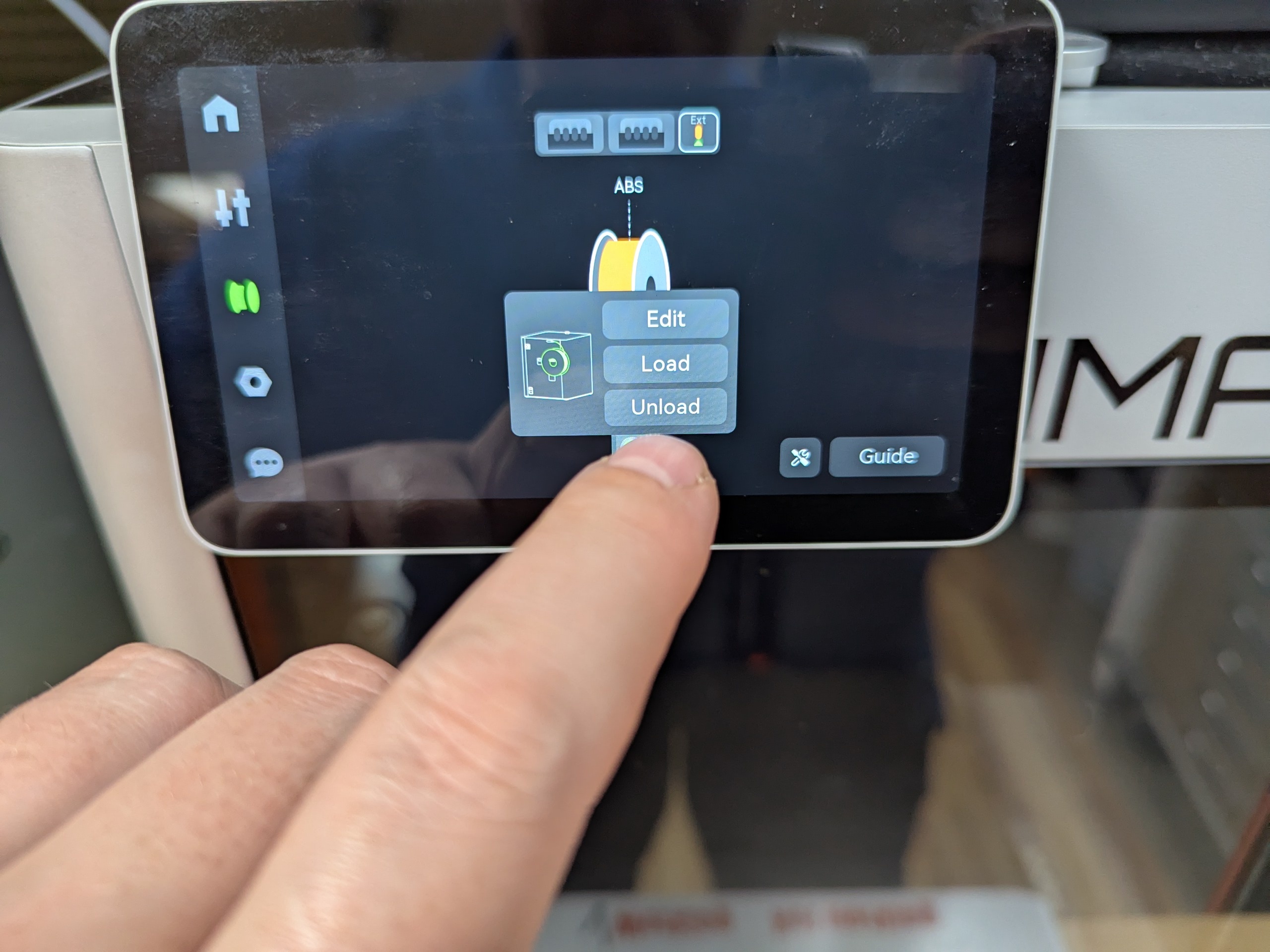

  • Set the spool holder filament type and color at the machine.
    • Click load button and monitor the extruder for filament extrusion into poop bucket.

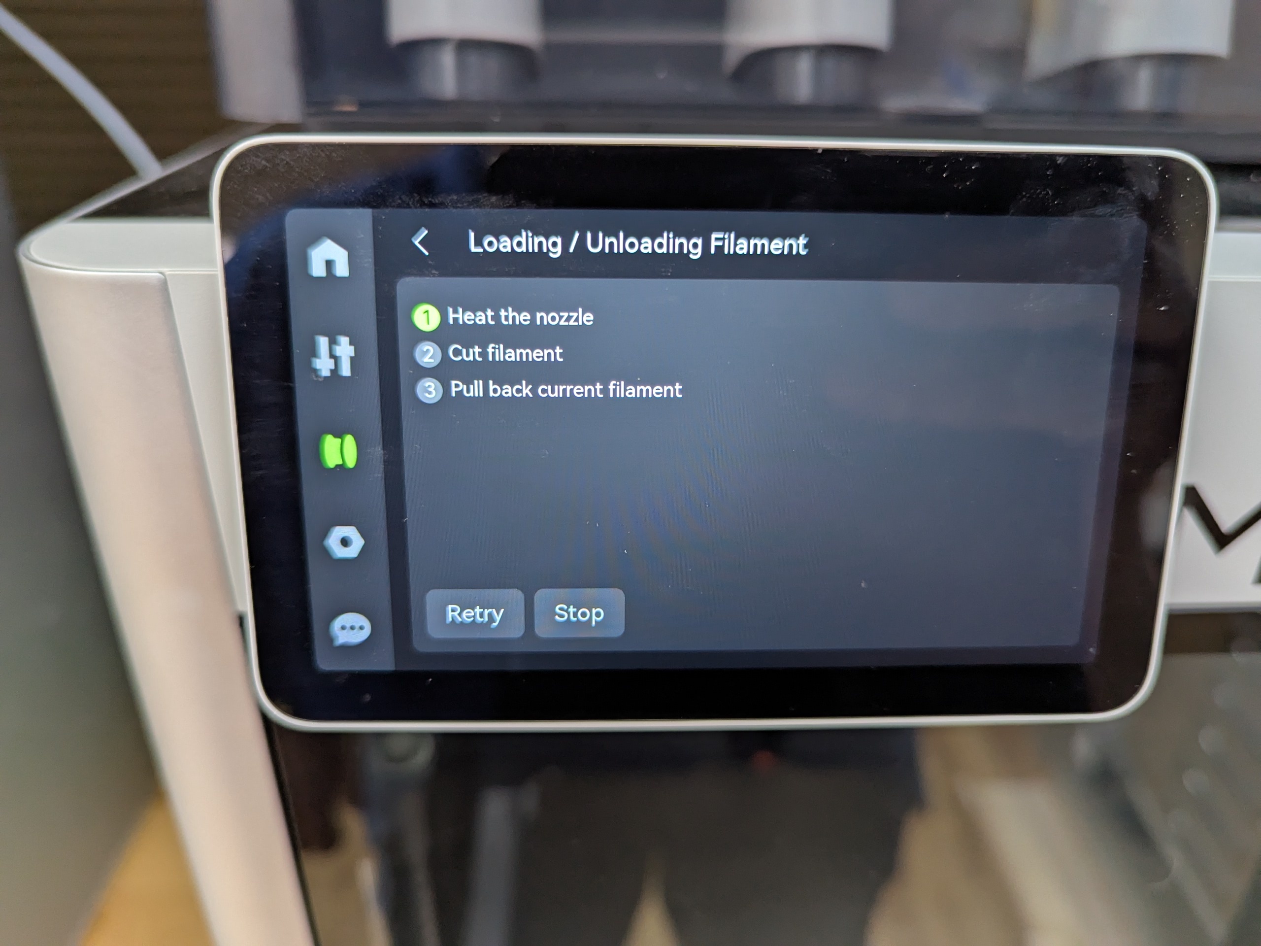

  • On the filament screen select the single spool and click the unload button and wait for prompt.

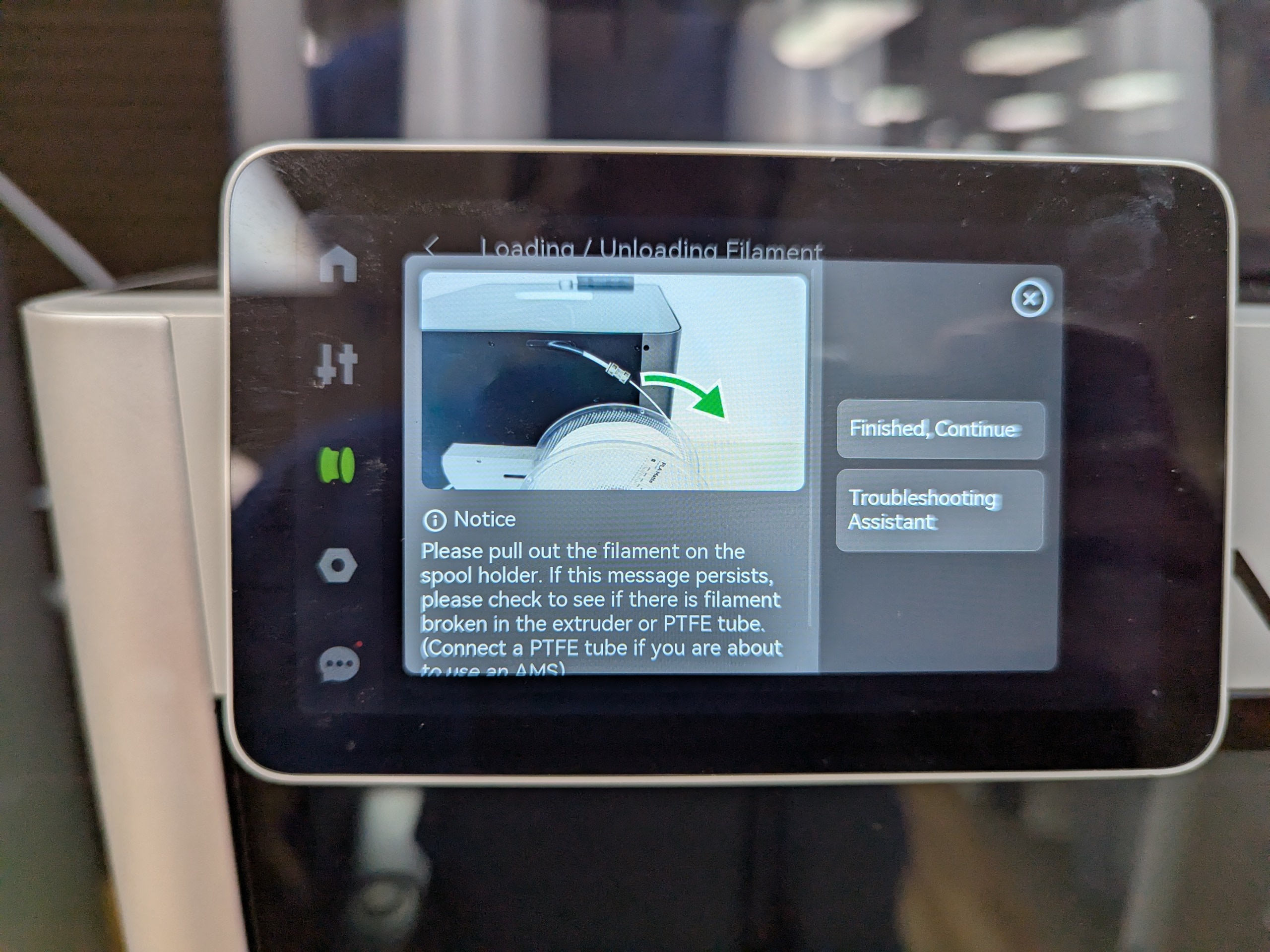

  • When prompted roll your filament all the way out of the machine and tube and remove your filament from the holder.
    • The line on the filament screen from holder to Extruder is no longer solid.
  • On Filament setting screen click the edit icon and press reset. This will remove your filament details and replace with a question mark.

  • I am seeing this error "Unable to feed filament into the extruder. This could be due to entangled filament or a stuck spool. If not please check if the AMS PTFE Tube is connected."
    • This can be caused by one of the following.
      • You did not confirm that the side spool holder was empty and tried to feed filament in from the AMS.  Unload the AMS Filament and follow the above steps to completely remove the filament loaded from the single spool.
      • Your filament spool is tangled.  Unload and check your spool if it is tangled then reload.
      • Yours or prior filament used was brittle and broken off in the tube.  If above does not resolve than this is likely the case. Open a ticket and a maintenance person will properly remove the broken filament.
