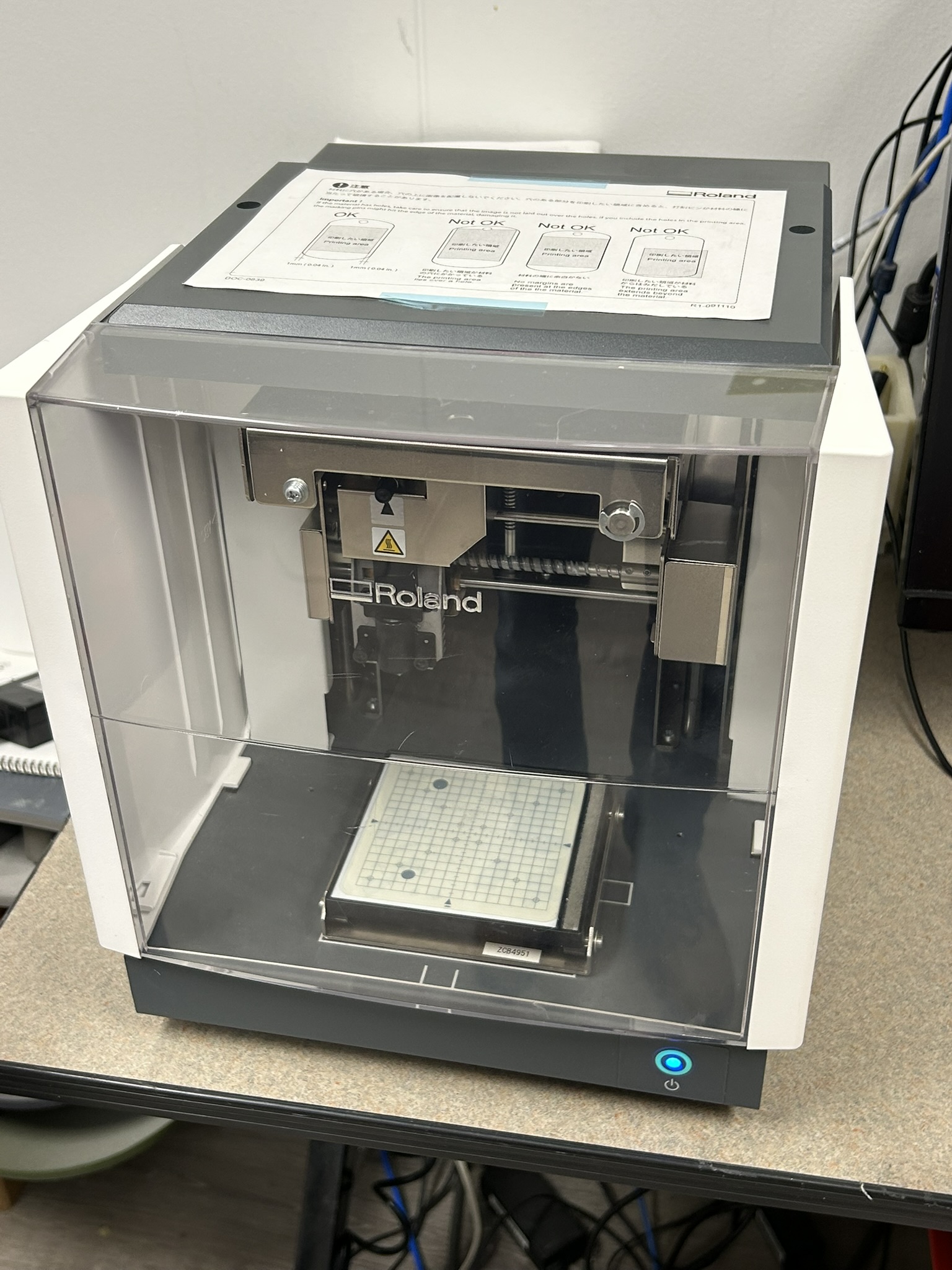

Q: What is the printable area of the MPX‐90?
  • A: The MPX‐90 has a printable area of 3.15”x3.15” (80mm x 80mm) with a Z clearance of 1.57” (40mm).
Q: What is the largest item I can place into the MPX‐90?
  • A1: With the cover open, the MPX‐90 can accommodate:
    Length: 3.94” x ∞ (100mm x ∞)
    Width: ∞ x 3.94” (∞ x 100mm)
  • A2: With the cover closed, the MPX‐90 can accommodate:
    Length: 3.94” x 7.87” (100mm x 200mm)
    Width: 7.87”x 3.94” (200mm x 100mm)
