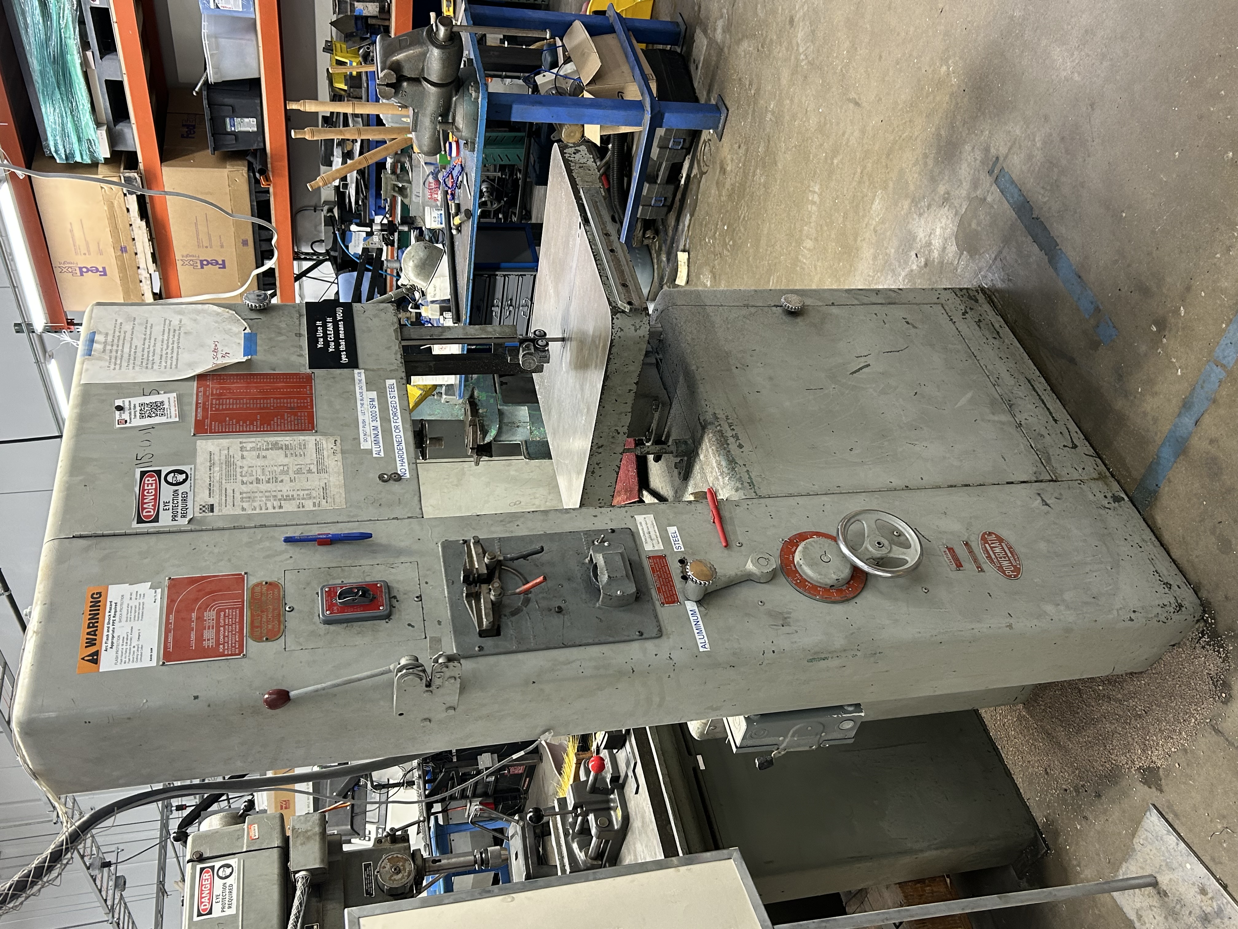

Name
Powermatic Band Saw
Date Acquired
Training
Training Video Required: PowerMatic Band Saw Video
Manufacturer
Powermatic
Description
Mild steel, aluminum, brass, and other soft metal. No hardened or forged steel. Best for materials less than 2 inches in thickness.
