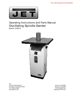

The spindle sander is used to sand internal radii (external radii should be sanded on the horizontal or vertical sanders).
  • Select a spindle that is slightly smaller than the curve to be sanded.
  • Make sure spindle is properly secured on the main shaft.
  • Use table insert that has the smallest opening possible without contacting the sanding sleeve.
  • Turn on sander and allow it to reach full speed before starting work.
  • Hold workpiece firmly against the table at all times.
  • For best results, keep the workpiece moving against the spindle.
  • Make sure to use the erasers to pull the sawdust from the spindle and increase the life of the sandpaper.
