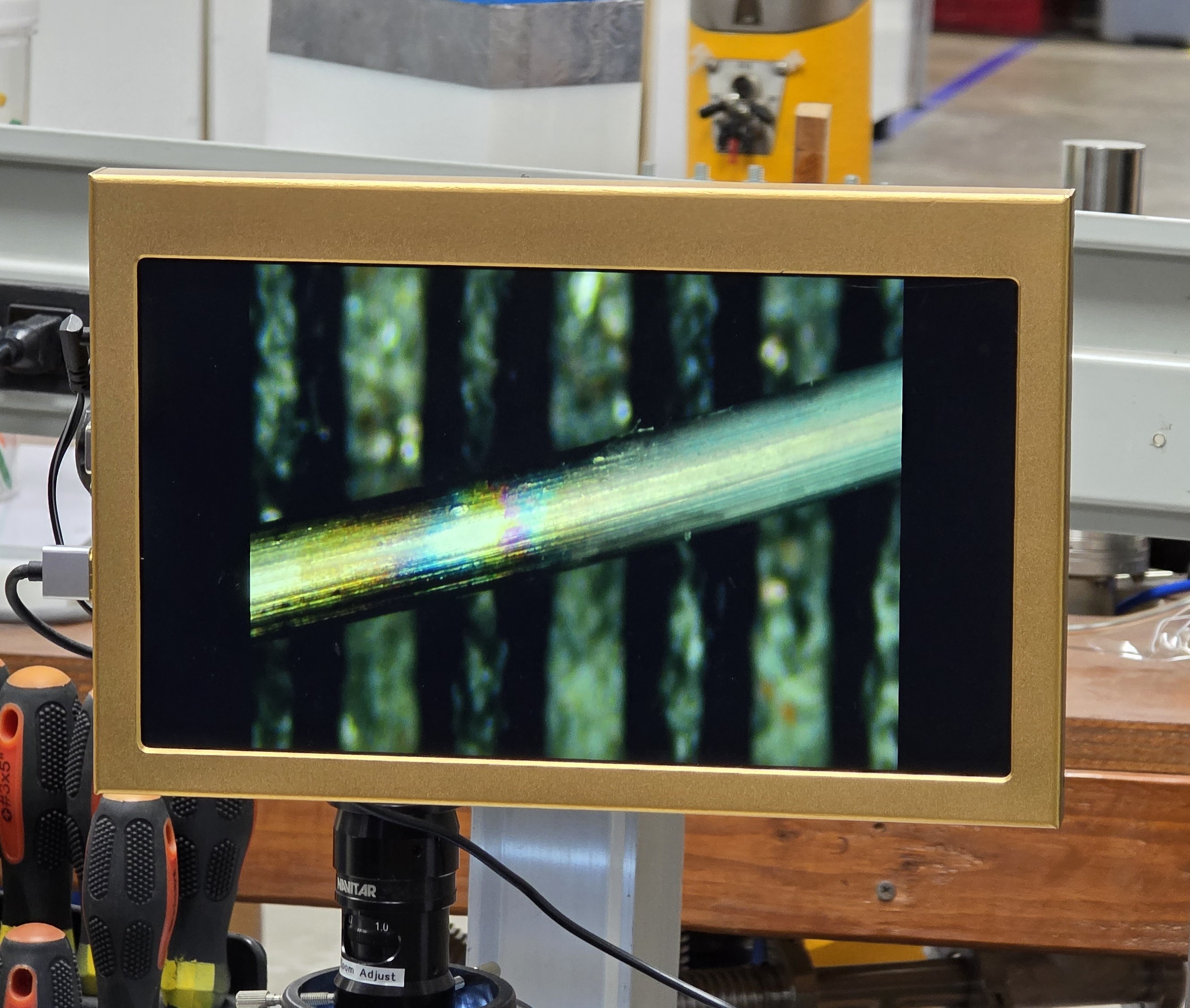

1. Titanium Anodization
Various thicknesses of oxide were obtained on Ti by applying different voltages to give multiple colors on a simple wire "DMS." Blues and yellows and purples were easily obtained but we did not have the setup to easily achieve the high voltages necessary to get a uniform green colors. We were only able to get a tiny speck of green that was visible under a microscope.
