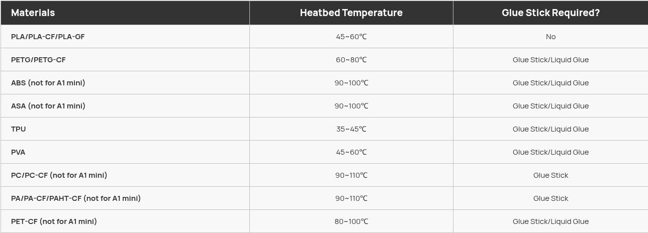

      1. Note the smooth side may require glue to ensure prints will be easily removed after printing.  Below table and link has list of filaments that require glue for the smooth PEI plate.
      2. https://us.store.bambulab.com/products/bambu-smooth-pei-plate?id=581066408204677122
