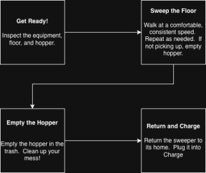

Step-by-step guide
- Disconnect the Sweeper from the Power Charger in the North Logistics area.
- Don the appropriate PPE for your comfort level. Sweeping up dirt, dust, and clay from the shop areas may cause irritation to your lungs depending on your allergies. Use a N-95 mask and safety glasses if you feel that you need it to use the machine safely.
- Check to make sure that the Main Hopper Bin is empty. To do this, you'll start by identifying the components that are required for this operation: knob with the handle (yellow), the bin release knob, and the molded hopper handle.
- Ensure that the machine is off.
- Using the yellow-balled handle on the main machine, move it left and right.
- below that, there's a smaller handle. Lift that handle up, and remove the hopper.
- If there's any dirt and debris in the hopper, dispose of them in a trash can with a liner.
- Ensure that the hopper is seated correctly, that the sweeper is not sitting on debris, and then turn the sweeper on by toggling the switch on the front side of the control panel. Usually, I'll select the middle of the three option modes: it runs the side brush as well as the main sweeper.
- Walk at a constant, comfortable pace – not too brisk, not too slow. If areas need a second pass, feel free to run the sweeper over it again. If the machine isn't picking up, follow the instructions in step 3 and empty the hopper.
- When finished, follow the instructions in step three and empty the hopper.
- Park the sweeper in its home in the North Logistics area, and plug the sweeper in to charge.
